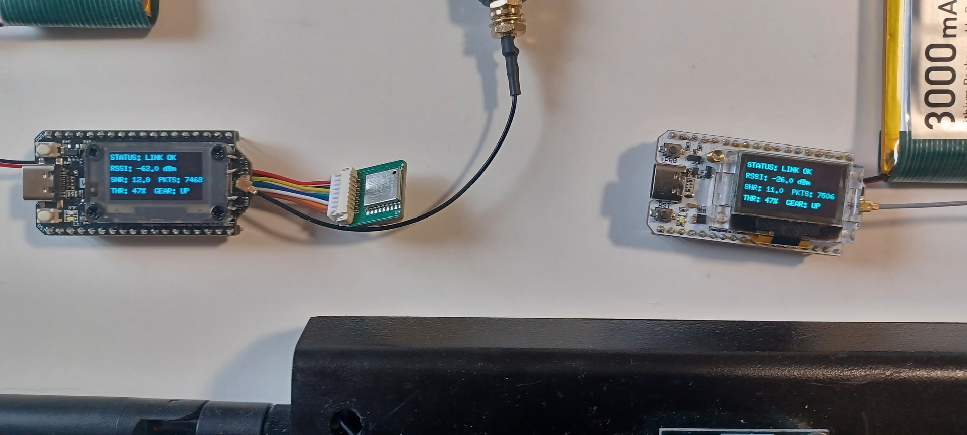

Hi,
I don’t use Meshtastic, but my own sketch.
I ran another test. The transmitter is a V4.2.
Results:
  • V3.2 -26dBm (-26 !!! Seems to be not possible).
  • V4.2 -62dBm
Same power supply, same antenna, same code (except for the pin numbers).
See the photo. The V4 is on the left, the V3 on the right.
The black box you can just make out below is the transmitter. It’s located less than 20 cm from both receivers.
-26dBm, I agree with you, that seems impossible. And yet…
Could the problem be with the “RadioLib” library?
Regards,
Eric.

Hello Eric,
Thank you very much for sending your sketch and for the detailed explanation.
After checking the code, one important point stands out: the sketch is clearly written as an adaptation for Heltec V3.2. Because of this, the test result cannot be used as a direct and reliable performance comparison between V3.2 and V4.2 simply by changing the pin numbers.
In addition, your test is being carried out at very short distance and with high transmit power. In such a close-range setup, RSSI values can become misleading and are not always suitable for judging the real reception performance of different hardware versions.
So based on the information currently available, we would not conclude that the Heltec V4.2 hardware is unreliable. At this stage, it appears more likely that the result is influenced by the V4 adaptation of the code and by the very short-range test conditions.
Hello,
Thank you very much for this feedback.
Indeed, I think it’s possible that, at such a short distance, the receiver is saturated and the measured RSSI value is incorrect.
I should have run some tests with a lower transmission power…
In the coming days, I will conduct further tests, making sure to maintain a distance of at least several meters between the transmitter and receiver.
Furthermore, I will validate an intermediate and identical power level on V3 and V4 (the two transmitters).
I will then check the received RSSI on the same receiver located several meters away. This will allow me to verify the values ​​more reliably.
I will get back to you if my measurements reveal anything interesting.
